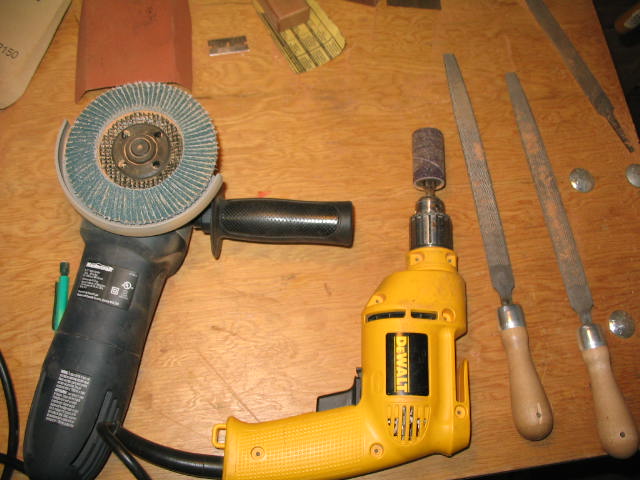

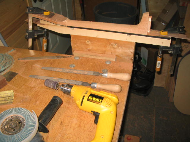

Well I knew when the hardware store had angle grinders on sale for 70% off I just couldn’t pass it up. Inspired by our friend Mario I went out and bought my angle grinder for under $25. I intended to buy a wood carving blade of some sort, but I decided before I did that to try a sanding wheel. So I bought a 60 grit sanding wheel for $10. I finally needed to carve a neck a few days ago and thought I would give this a try. Wow! This thing cuts through wood like a hot knife through butter. In 15 min I had taken the uncarved neck to where I just needed to clean it up with the rasp. This is the best $40 I spent on tools in ages and it is going to be a great time saver. You do have to be careful as it removes wood really fast. When I finally shut the grinder off I realized just how close I came to removing to much wood. I plan to try a few more with the sanding disc before I think about upgrading to a carving blade. The only disadvantage is that it throws dust everywhere. I suppose a carving blade would throw small chips which would be easier to clean up.
Here are some pictures of my neck carving tools. Angle grinder, drill and drum attachment (doesn’t get used to much), Nicholson rasps.
If your looking to speed up neck carving this is an easy and inexpensive way to start.

Josh – good stuff. If you are looking for something more aggressive, Lee Valley carries the Kutzall, Arbortech and Lancelot blades.   I use a Lancelot for carving Archtop – top and back plates. I wouldn’t use a Lancelot for carving necks as its too aggressive for my taste and you have to be very careful that it doesn’t kick on you particularly as you approach the heel).   If you were able to rough carve a neck in 15-mins with 60-grit and found it aggressive – you might want to think twice about using a Arbortech or a Kutzall. (If you get one of these please get a good leather apron).
I agree its easier picking up shavings and chips from a Lancelot – but I still wear a good dust mask and good safety goggles are a must as its easy to get chips thrown into your eyes (major ouch).
Just my 2?.
PostPosted: Tue Feb 14, 2006 3:13 am
Posts: 908
I use the Lancelot, and a full face shield would be highly recommended <g> And yes, the chips are large enough that they are easily swept up.
If you want to try it, cut up a couple two by fours into neck sized chunks first, and practice on them. The thing removes wood at a crazy rate. Takes less than a minute to go from Lancelot to rasps...
Wear heavy leather gloves, too. The lancelot is one dangerous outfit. Low angle, and pretend you're petting the meanest cat in town. Be gentle...
